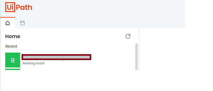

Also, if I try to run process from UiPath assistance (in different machine when I developed robot) there is a label than mentions “awaiting install” and if I click in option install it marks the same error that in orchestrator. In summary, I can’t run my process neither from orchestrator nor UiPath assistance. I can just run my project from machine I developed it.

Status UiPath assistance connection
