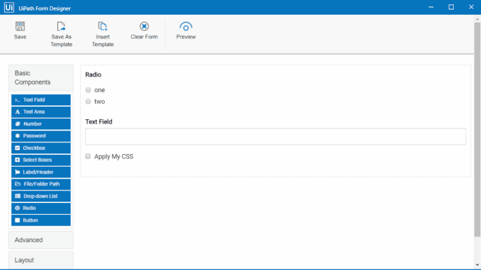

Is there a way to create a button in Forms to clear all fields and separate button to close and stop the process?

If my understanding of your question is correct, here is the solution to set all fields out to their initial state (reset all fields):
For the second part of your question … I think the simpliest solution would be to have second submit action button with different key on the form. After you have it, just check SelectedButton output argument of Create Form activity in your workflow.
Thank you!!! that worked perfectly!!
