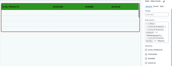

I´m having trouble working with the filter function and I´m hoping someone can give me some clarity of what is happening
Take a look…

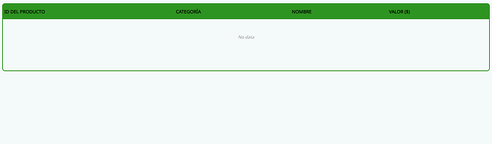

It´s simple, I´m trying to filter various table based con column values. When I apply multiple conditions to the expression the result is no data shown, as you can see here…
But if I apply one condition everything works fine
This little problem is affecting my whole solution and I´m unable to understand what is wrong.

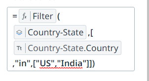

@Luis_Fernando - Support for OR conditions in Filter has been a long-standing requirement but nor present. Right now, it just works as AND. Related thread: How to add Or filter condition in uipath apps - #13 by Naveen.Ch

The condition on this table works as “AND”. This works but not with multiple conditions where “OR” is the intended operator. In case my previous response was confusing, this is a missing feature in Apps. I love to use UiPath Apps too but missing basic features like this makes me nervous to fully commit and offer it as first-in-mind solution for client needs.

I believe this is what you should give for getting both the values related data…Can you please try the same
filter(source,[Column,"in",["Mixto","Hamburguesas"])
cheers
@argin.lerit @Luis_Fernando ,
This works with In Operator. The logic you want to implement you can do using In operator into filter condition.
However OR Condition is also available and that validation OR logic based on your input. Please try below logic to get your data right now.

@Arvind_Kumar1 Thanks for the great example!
Thank you very much Dear friends @Anil_G @Arvind_Kumar1. This expression did solve my problem. Glad to count on y`all
