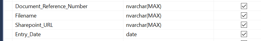

I have created an app in UiPath based on client requirement to display certain columns of database table. Among which one of the columns ‘Entry_Date’ of type ‘Date’ should also be displayed.

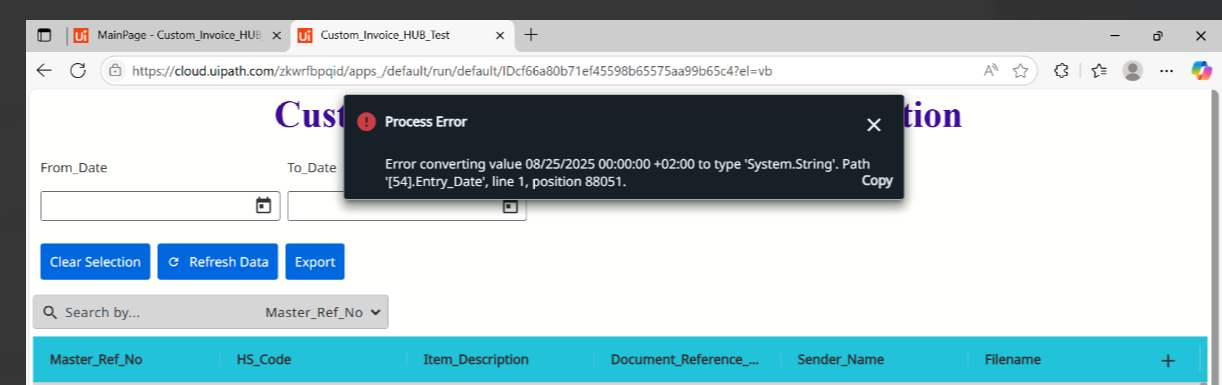

The bot is working as expected when run from studio or orchestrator. However, I am facing the error - ‘Error converting value 08/25/2025 00:00:00 +02:00 to type ‘System.String’. Path ‘[54].Entry_Date’, line 1, position 88051.’ only when I am triggering the process through App.

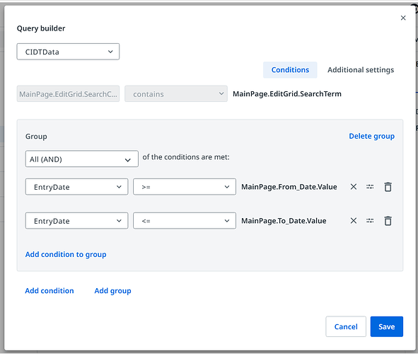

I am posting the error screenshot, datafabric entity and filter details of the same.

As per error the value you are trying to display or the column cell value is not matching destination type and is not convertible
can you check the specific line that is failing looks like it have the id or sequence number as well in error

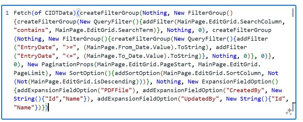

yes. I am using the string

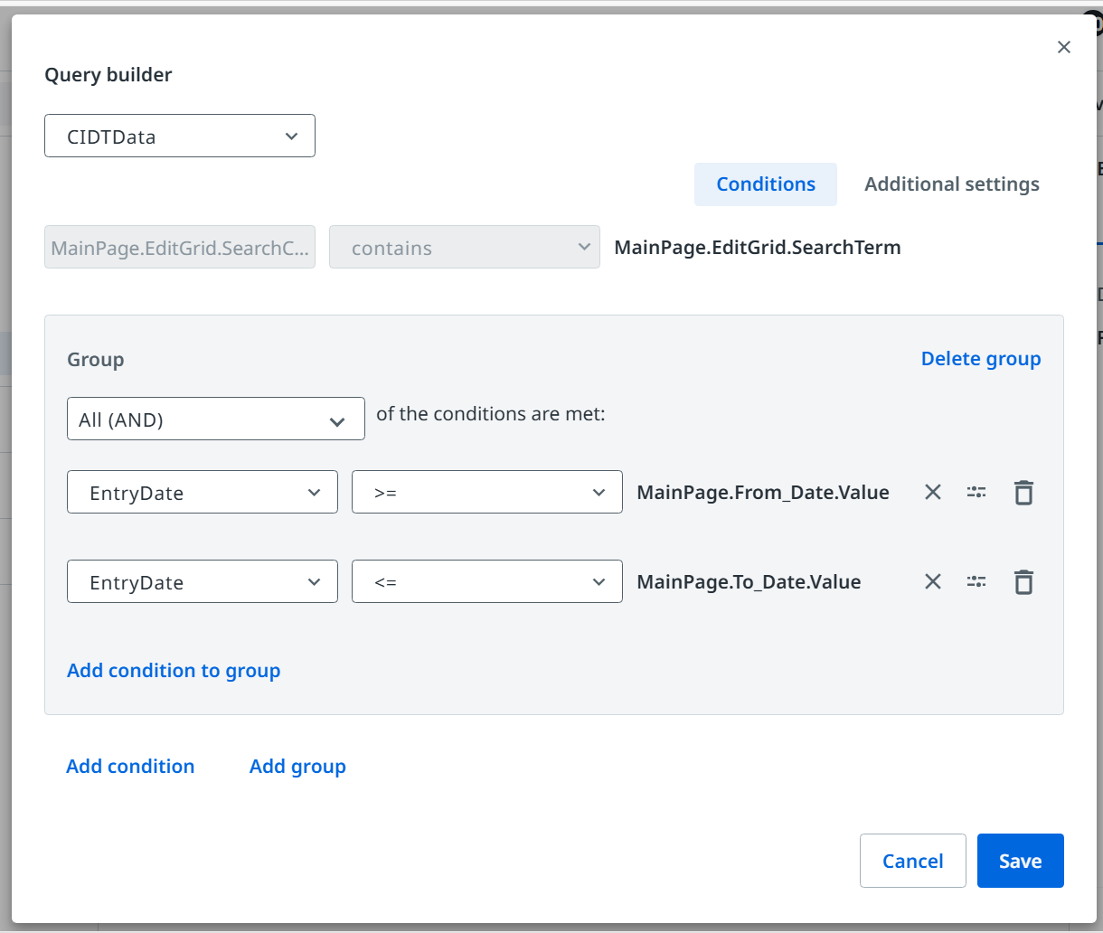

This is the filter that I am using
@aishwarya.nagaraju
I see the filter ..thats what I am mentioning that mostly the .ToString in filter is creating the issue
Screenshot 2025-09-18 at 12.33.38 PM
Remove it and check

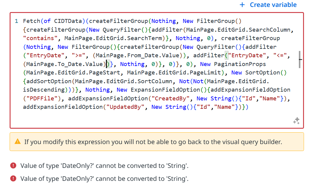

Hi @Anil_G ,
This is error I am facing when I remove .ToString
Please let me know how can I convert this to ‘DateOnly’.
@aishwarya.nagaraju
Got you..it is added by default when you select the date type

I have checked this with multiple other date entries. But the issue remains the same. From the screenshot I believe that the offset ‘+02:00’ is causing the issue as a ‘+’ symbol cannot be converted to string. Is there any way that I can remove the offset before displaying it in the app.
Thanks in advance.
