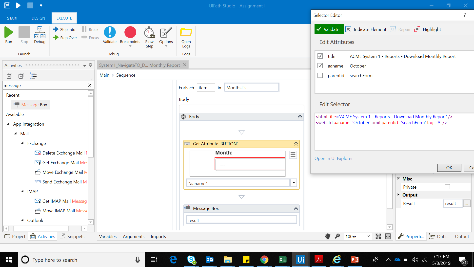

Trying to fetch list of items from dropdown list
I want to list fetch list of items in a drop down and I have gone through other topics on forum but couldnt
Tried using find element
and Get Attribute
This result is showing as October 2 times
I dont want hard code months but want to get list of drop down values in to variable. Please help with my missings.

Tried and looks like find children not retrieving any value. Can you please check thatSystem1_NavigateTO_Download Monthly Report.xaml (12.6 KB)

Can you please let me know changes done. I see For each loop type argument has been to changed to Uielement instead of object
and I have just downloaded your xaml and executed and it shows error but at the same time it doesnt prompt result message box.
Please correct me if still missing in understand.Apologies for inconvenience

  • Find Children output is always of type IEnumerable ( Collections type ) so when you loop this, you should change the type argument into UiPath.Core.UiElement which you can find in the Browse Section. So that all the elements which you iterates from the loop will be of UiElement.
  • If you see the Element property of Get Attribute , i have passed for each loop variable Item into it, the reason being it generates the selector of the first element of the dropdown.
  • If you display the output of Get Attribute it would be the drop down element(aaname)
These are the changes i have done in your code, you can make some changes accordingly by comparing both and run. If you Still facing the issue, kindly send me the browser link.

Sorry for the late response.I see all the changes given are incorporated but still workflow is not getting inside for loop
System1_NavigateTO_Download Monthly Report.xaml (12.7 KB)
@Leela_Javvaji
Looks like you are scraping wrongly in Find Children Activity, try by scraping the entire region of drop-down instead by scraping only July, for example

FYI…If you scrap only July, only the details of July going to add and if you scrap whole drop-down you are going to get whole data into one Collection(UiPath.Core.UiElement), hope it helped
Thanks,
I have changed selector as the below
Can you please let me know how to select whole dropdown in a single click
@Leela_Javvaji, plese scrap in Find Children, send me the URL link
Month field @ ACME System 1 - Log In
Find Childer Selector as
@Leela_Javvaji
I’m telling to scrap one more time in find children, refer the above picture and scrap like how i did for another dropdown

Find children -
- you are suggesting to update like this?
@Leela_Javvaji
Yes…
