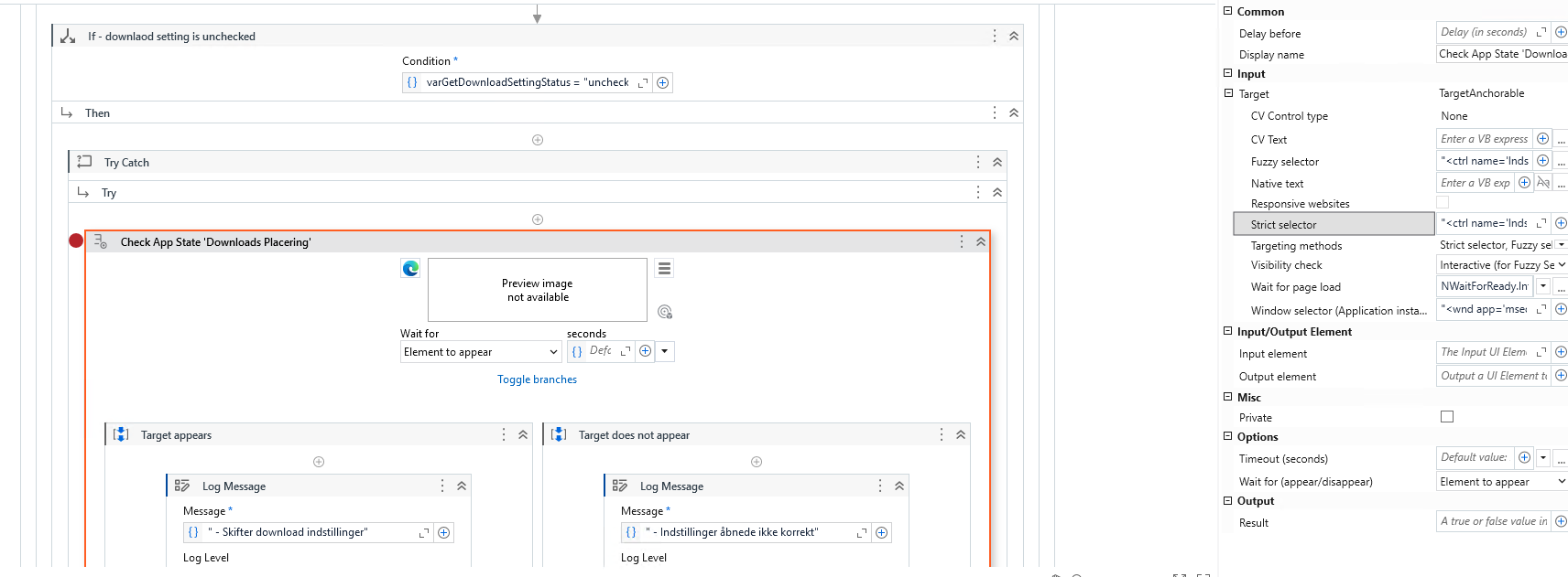

I’m running Stuido 2025.0.166 STS and trying to use Try/Catch activity but it’s giving me option to check the “ContinureOnError” option. Have a look on the picture.
can someone tell what is wrong and how can i solv this issue?
@Shazi_Latif,
There is no Continue on error property available for Try Catch activity. By default any error occurs in Try block gets handled in catch block and execution flow continues without any error being thrown.
May I ask why you are looking for that property?
There is no propertied for this action, if any errors occured it will go to the catch section if you find any error in try it will go to the catch block and there you can add your logics in catch body section for more idea on Try catch try to look on below thread.

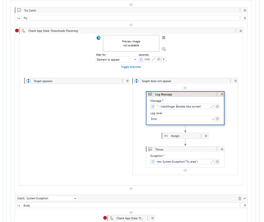

OK I did something which I shouldt do in try/catch as you all said it should go by it self to catch which it’s not doing..
After being tired I tried this.. I added a Throw activity to send it to catch area.. and now its going to catch area.
In that case it was always working as expected.
Its simply that the code in your Try didnt have an error, and as such it never needed to go to the Catch.
The Check App State doesn’t decide if an element not existing is an error, as that might be the desired state. It is up to you to determine that path is an error in your flow and throw an exception as you have done here.
No i did had Log message as Error .. and without throw it still not going to CAtch area..
Yes but my issue is here.. that it’s a library workflow and we are not adding any throw in libraries. So that way i wanted to avoid.
Log messages are not considered in a try catch, they are just for logging and will never interrupt your code.
So it is correct and the intended behaviour that it will NOT go to the catch area if you simply log the error via a log message.
You have to throw an exception yourself or the underlying activity needs to throw the exception.
