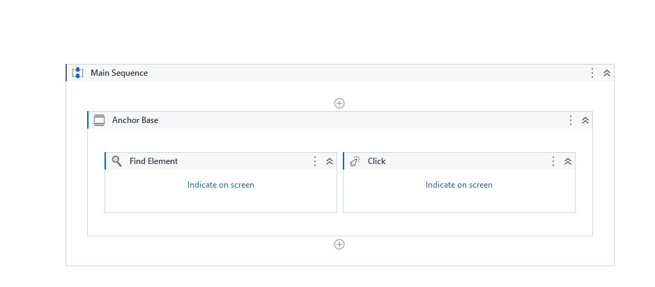

Hey @toshiki_kubo
Try to make a use of this :
You can make your selector dynamic by using the wildcard for more than one character " *" for one character use the “?”
(Activities - Anchor Base)
For your reference:
