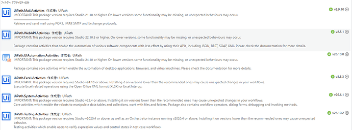

I have two development environments, one with Orchestrator and the other without. When I opened what I developed on the Orchestrator side in the environment without Orchestrator, I received an error saying that certain activities do not exist. Upon investigating the cause, I realized that the package versions are quite different.
  • The attached image is from the environment with Orchestrator. The environment without Orchestrator does not have such high versions like 2.4.xx or 24.xxx.
    I asked Gemini about this, and they suggested that I might be using a pre-release version. However, when I checked the box for “Include pre-releases,” even higher versions appeared, so it seems that I am indeed using officially released versions.
The UiPath versions in both environments are the same (Studio 2024.10.16). How is it possible that the downloadable package versions are different? Additionally, I created this in the environment with Orchestrator, but the actual execution environment is without Orchestrator. In this case, will I need to downgrade and recreate it? (´;ω;`)
At the beginning of the scenario, I am using “UiPath.Web.Activities.Http.NetHttpRequest (HTTP Request),” but it seems that this activity does not exist in older versions…

Is the environment without Orchestrator a closed network environment? If it can connect to the internet, missing packages can be automatically downloaded from the feed online, but I don’t think that’s happening.
For now, the easiest solution would be to copy the contents of the
c:\Users\[UserName]\.nuget\packages
folder from the machine connected to Orchestrator to the same folder on the machine without Orchestrator. This should resolve the issue. (In some cases, you may need to copy a few .nupkg files.)
If you want to prevent this issue in the future, you can create a project using the version of the activity packages bundled in 24.10.16. (Since the default is this version, I think it would either be that you explicitly upgraded or that you used such a template.)
