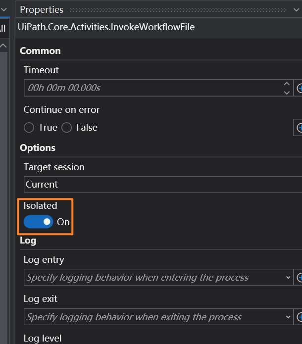

Might be useful for someone, remember to turn on “isolated” option within your InvokeWorkflowFile activities
