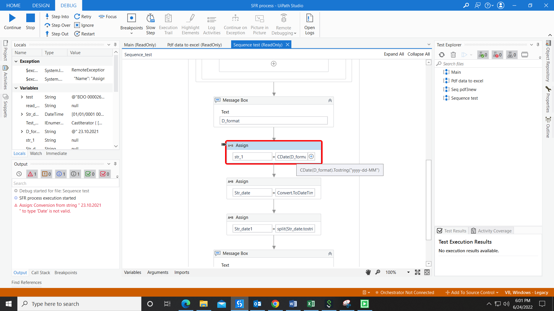

I used Cdate to convert into date
str_1= CDate(D_format).Tostring(“yyyy-dd-MM”)
Str_date = Convert.ToDateTime(DateTime.ParseExact( str_1,"yyyy-dd-MM”,System.Globalization.CultureInfo.InvariantCulture).ToString(“MM-dd-yyyy”))
Like this i am getting i want to remove 00:00:00

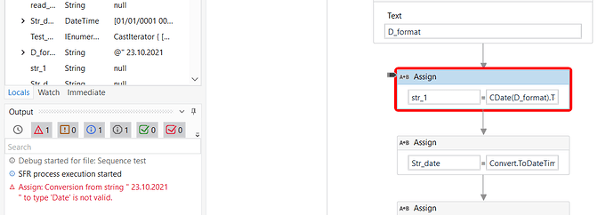

Assign: Conversion from string " 23.10.2021
" to type ‘Date’ is not valid.
What changes i need to do ,getting this error, the format should be MM-dd-yyyy.

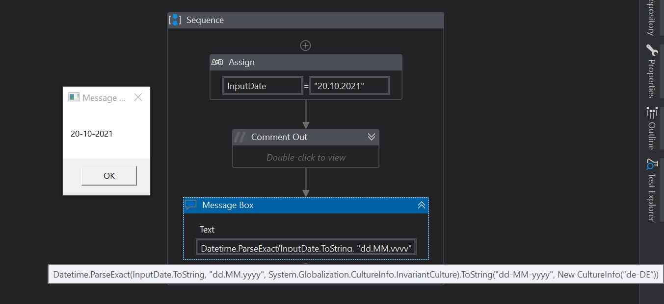

Hi!
Try this and let me know:
Datetime.ParseExact(InputDate.ToString, "dd.MM.yyyy", System.Globalization.CultureInfo.InvariantCulture).ToString("dd-MM-yyyy", New CultureInfo(“de-DE”))

Hey!
Can you show me the input date?
I created a logic for 20.08.2022(Dot Format)
You can refer the post which is created by @RK_0
NaNi
@THIRU_NANI ,
This is the input
