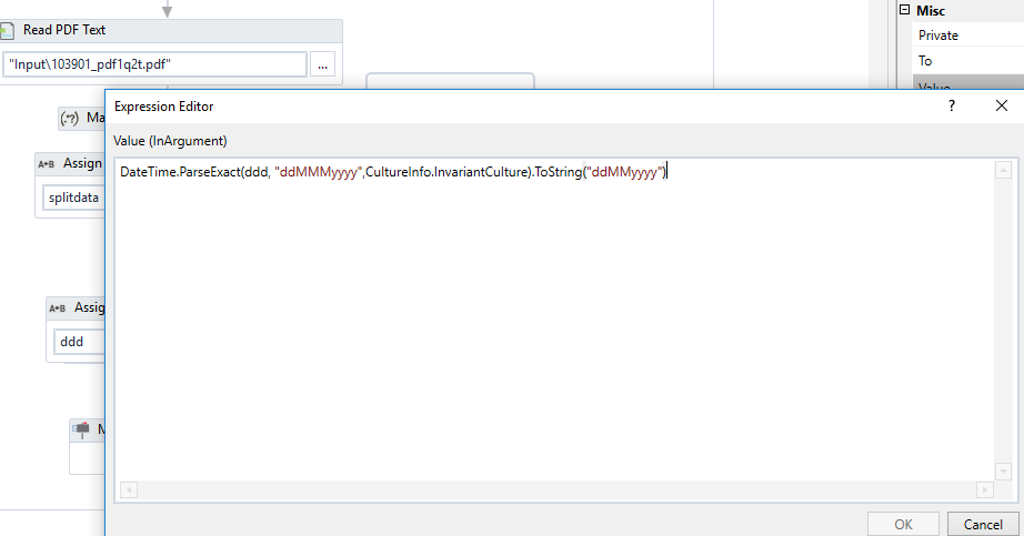

I used this code to

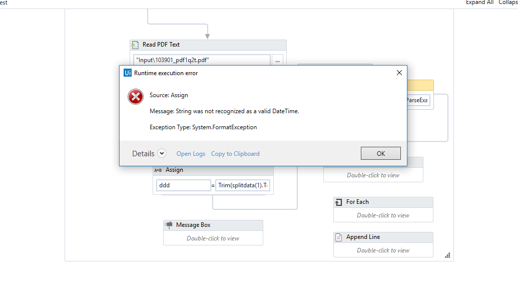

Yes when I am trying to do with dash also still it is not fetching.

The fact that the original text in PDF is bold should not matter if it is being extracted correctly; In either case, I would check what the value of ddd is the format you are placing in ParseExtract() matching the expected format of the string.
To help you further, we’d need a sample of what the value of ddd after you’d extracted and split the data.

From the sounds of it, the content of ddd is not in the expected string or format, without more insight, logs, screenshots, etc. we’d only be guessing, and I can only point out your original post has a format conflict between “12-Oct-2018” and “ddMMMyyyy”.

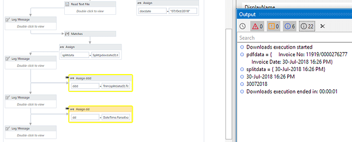

Swapping your PDF out for a text file with the same content…
splitdata =
string[1]
" 30-Jul-2018 16:26 PM"
So Trim(splitdata(1).ToString) is not valid. changing it to an index of 0, will get you a step further, but the format in
does not match the content 30-Jul-2018 16:26 PM which I pointed out in an earlier post.
Based on the test.xaml file you provided, You NEED to change either 1) Regex, 2) Date format, that you are expected along with the few index changes based on your current Regex.
Swapped PDF for TXT, Inserted Log Message activities
