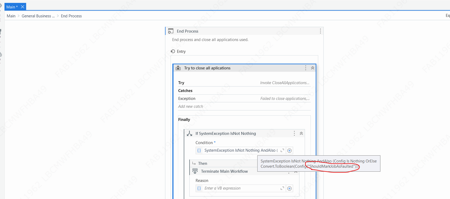

This value is used in the END PROCESS State in the final block of Close All Applications. As highlighted - If a process failed in the initialization stage or end after continues error in transactions, it will execute the END PROCESS State. In the end if the above value is set as true - BOT will terminate the workflow which will create a status as Faulted in the final status of the job run in orchestrator.

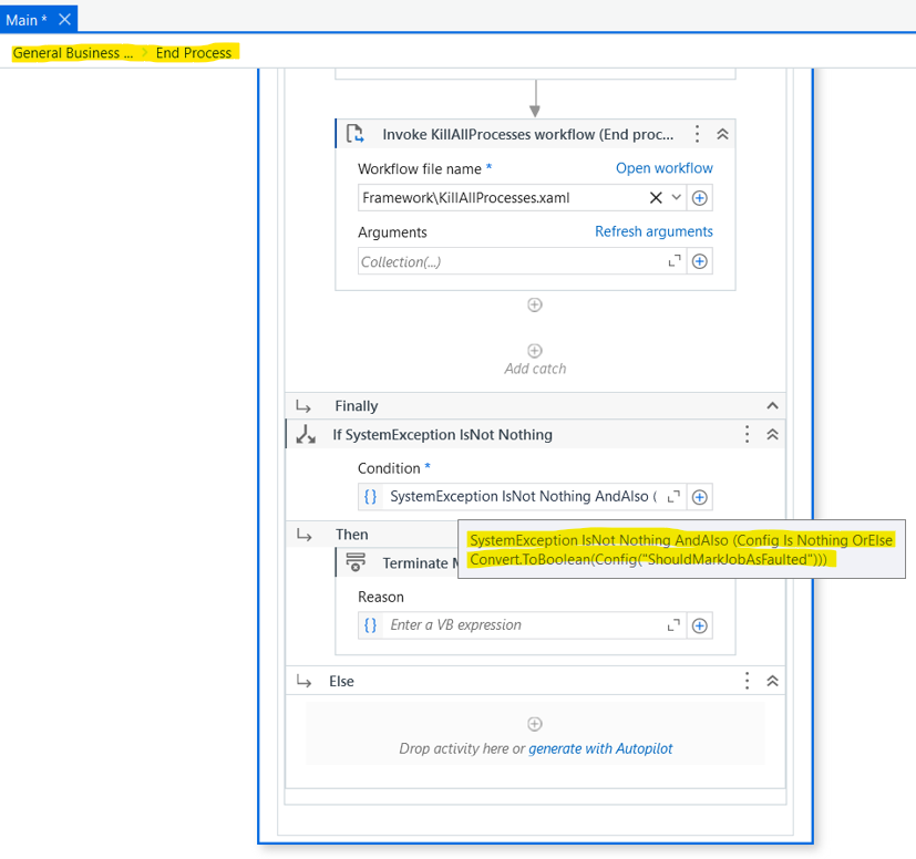

It was handled in End Process state, check the below image for better understanding,
Terminate workflow will Terminate the workflow so it sets job as faulted.
