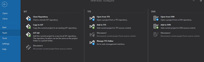

SVN and Git are source control solutions which we use to share and maintain our code. It’s like a repository that contain all the versions of your source code along with every edit you do to it. It is also a great way to share the solution files with our co-workers if multiple people are using the same code to develop. Let’s say you and I are working on some sort of a solution, and we both are working on the same solution files. So, if we don’t have a source control system, I would not know where your changes should go and you will not know how to merge with my changes. Having a source control system would handle this in a nice way so that when it syncs, it will take both our changes and we do not really need to worry.
Additionally, say I mistakenly edited some code and now its not working. And I can’t remember the change I did to correct it… So, to get it to the previous state, if you have source control, its just a matter of finding the edit I did, and rolling back to the previous version of that file
So, SVN, Git, TFS (Team foundation server) are such source control solutions which we can use for UiPath source management. All the are also integrated in Studio as you see here in the Team tab…
Git also provides free license to use for personal use. I use them alot to maintain my source code of the stuff I build. It is also a great way to backup your files in case you lose them.
Hope it is clear for you? Let me know if you need more clarity on this
This helped a lot, however, where would I get my repository URL from? the elipses on my window are greyed out and I’m not sure what to insert in the “repository URL” field.
