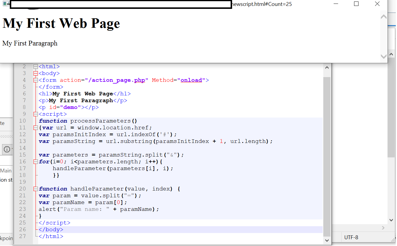

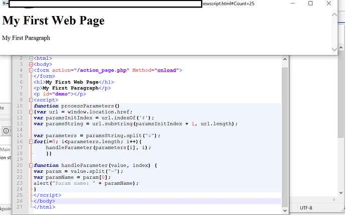

hi @juansaenz
I have tried the code you posted, but yet i am not able to display the value. Could you please help me.
I used that script inside the head mark and called processParameters() on body onload event. You are including the script inside the body. Debug using alert() function inside javascript.
<html><head><script type="text/javascript">...here the script...</script></head><body onload="processParameters();">...here the body...</body></html>
By the way, i have noticed that you are using a form with a local php file… That won’t work because it is a local file.
Furthermore, if you want to pass the data back to the process, you have to set result json in your submit function:
If you had an input like this <input type="text" id="myfield" name="myfield" /> it would be:
var variablevalue= document.getElementById(“myfield”).value;
window.external.setResult(“{‘name’:'” + variablevalue+ “'}”);
If you try it, let me know.
Happy coding.
hi @juansaenz i tried this. everything worked!
thank you so much for the detailed steps! :clap:
