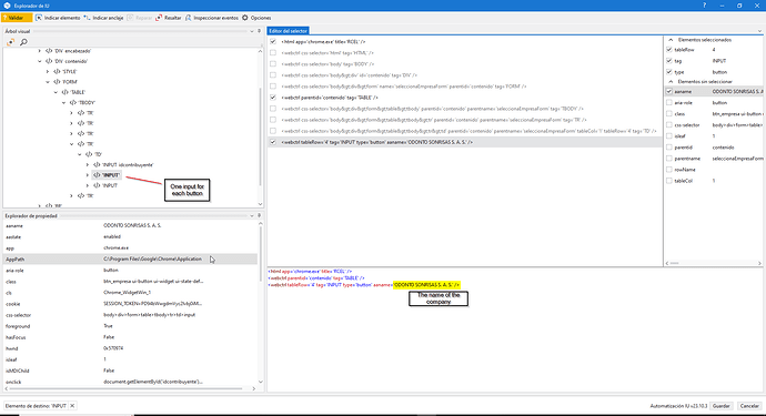

Can you please open the explorer and send the snip of ID of strict selector…?
Hello, sorry for the late response.
I understand that by explorer you mean the UiPath explorer, so I paste what I interpret that you are asking me

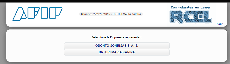

One more thing that I don’t know if I clarified, every time I enter the page, the number of clients varies, therefore the number of buttons also varies.
Hey @Matias_Clemente.Arg
Try removing table row attribute from the selector and retain only aaname.
this is how the descriptor remained

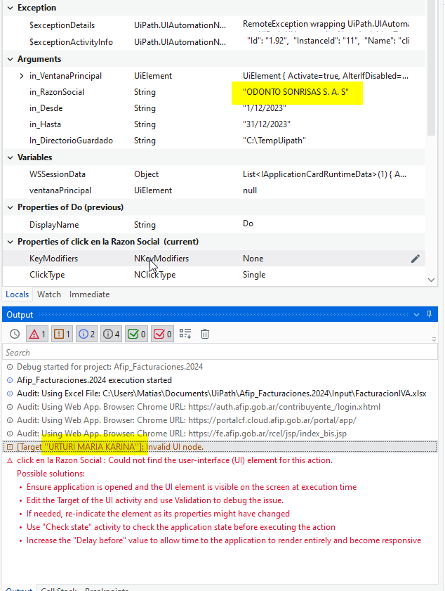

and get this error
One thing that catches my attention (although I don’t know if what I think is correct), the error that I get says in the name of the company as “URTURI MARIA KARINA”, when the company that sent in the argument is “ODONTO SMILES S.A.S”
In any case, I would like to say that following the suggestion of eliminating text checking worked correctly, although I still have a question whether or not the fuzzy selector should use text checking.
