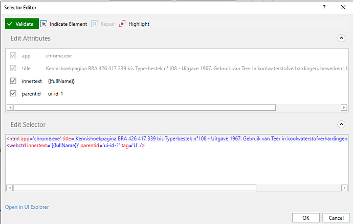

Using the UIExplorer I managed to select the correct item in the list by using the selector and not the FuzzySelector. Using innertext and a delay before on the activity.
When I change the value of fullName it selects the correct item in the list however only possible for the hard-coded page.
If I copy the second line from the selector to the fuzzyselector it gives an error “could not find the user-interface (UI)…”

Hi @RPAForEveryone
For the title I would use ‘Kennishoekpagina*’ since all pages to update start with this word.
But I can’t modify the first selector line - see screenshot in previous post it has a grey background → I can’s select or change it.
And when I put it in the fuzzyselector - it times out with the message no UI element found…
Hedwig
The top row of selector is frozen(not editable) when an activity is inside attach browser/attach window scope.
The top row applies to all activities within the sequence inside the attachment scope, hence it can’t be edited from the activity.
Modify the browser scope to match your desirable selector.

Selector:
<html app='chrome.exe' title='Kennishoekpagina*' />
<webctrl innertext='{{fullName}}' parentid='ui-id-1' tag='LI' />
