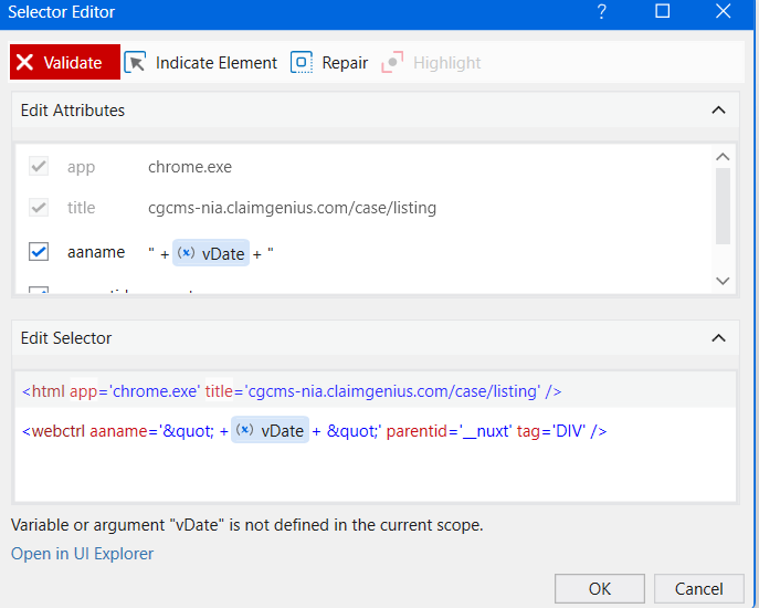

I have pass variable vDate in aaname but it is not accepted can u tell me why
i dont understand if it is accepted then whats the issue?
sry my mistake it shows validation error
This is my workflow
can anyone tell me solution regarding this error
Hi @yogitagaikwad2206
Please add a log message below assign activity to check what the exact output is coming.

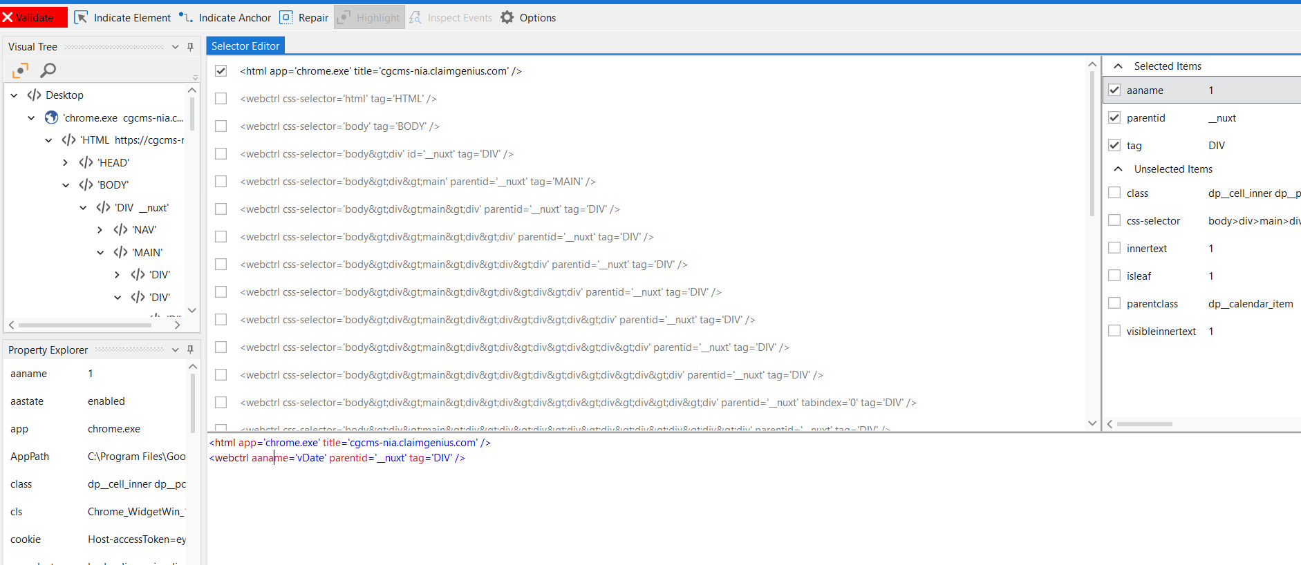

For previous 2 month date first change the month from June to April and then use the click activity to pick a date and pass the Assign variable in its selector.
Hope it helps!!
If you pass the variable the selector it will not validate but if the value is correct it will successfully complete the task.
I want to select current date from calender but when i pass variable in click activity it shows error
means without validate it will work
Yess it will work.
First get the from date as your 2 month ago date by changing the month and then pick the date by using click activity.
Then get the current date by changing the month to June and pick the date using click activity passing the date variable in it
