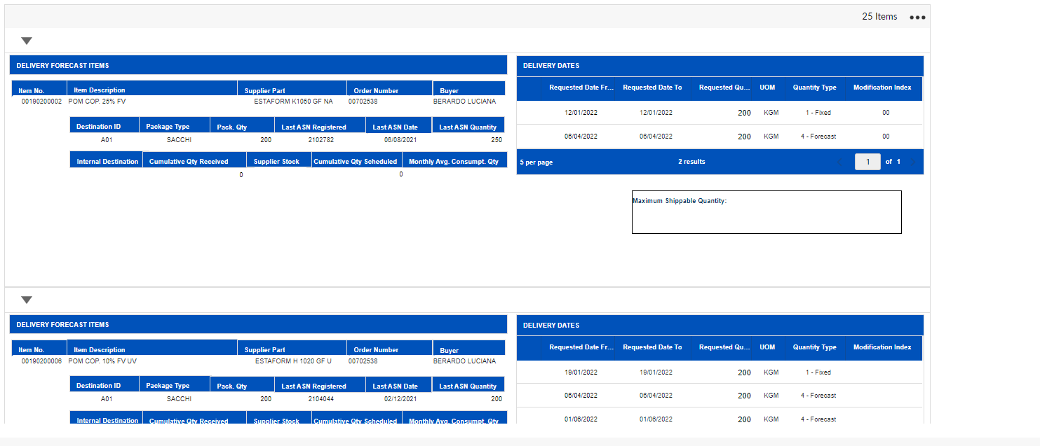

Can you shared the screenshot of the Table.

This is the table structure and I need to extract the data from right side table which span over multiple pages.
You can try with Data Scrapping and We don’t need to scroll the to extract the data just have a try @agathiyanv
Even If i do data scrapping it only captures the first table data.
Element exists activity is not highlighting the other tables and I also changed the selectors
but its not working.
It will work only for one line Item. But I have multiple tables
Do you have any sample site to make Proof of concept?
