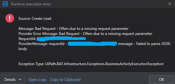

I have used Salesforce Integration activiy (UiPath.Salesforce.IntegrationService.Activites 6.1.0) and I have noticed that it runs into error when there is a special character in any of the fields specifically on the Created Lead activity. I originally experienced this in the Lead description field but managed to replicate the issue using the company field. This should be addressed as special characters are common in EU companies.

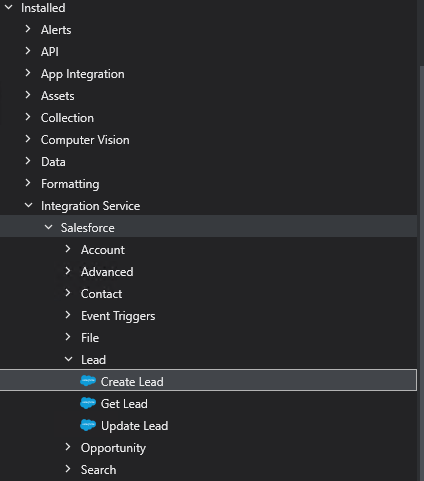

Hi @Akshay_Agnihotri, I don’t have an “Available” section in the “Activities” tab, but I do have the “Installed” activities. This one is from the installed activities.
And here’s the special characters I tried that causes error:
ä
ĂĄ
ñ
ö

Hi @Akshay_Agnihotri I have tried using DAP today and unfortunately the issue exists there as well. Any advice?

@Akshay_Agnihotri Sure… that is also okay but I would say the issue is easy to replicate. Just use a special character on any of the fields in “Create Lead” and the error will come
We have created a ticket i.e. ENGCE-41104 for the above issue and will look into it.
