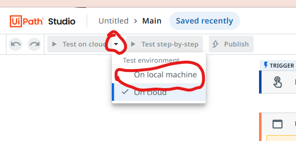

please try this
cheers

@Matias_Clemente.Arg
in cloud when you debug you can either run on local or serverless cloud robots
when scheduling or running in unattended then you can choose any configured machine as well
cheers
