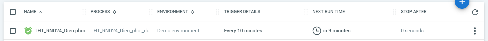

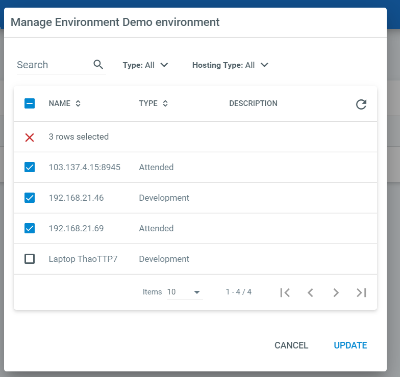

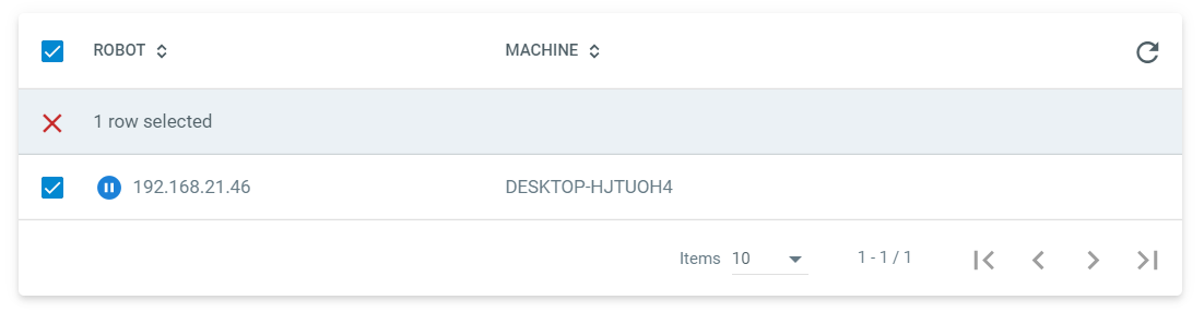

I setup robots, connect and everything. The environment contains 3 robots but in schedule, only one is shown. Pls see the pictures below and give me some advices. Thanks!
Fine buddy @tranthao240495
Usually in schedule we will be mentioning only the process name and obvious we will be having the environment tagged to a process and when we run a process manually with jobs, we will be selecting any robots available in that environment…thats right
but we have option in the schedule tab while creating a schedule called EXECUTION TARGET where we will be mentioning whether to run in ALL ROBOTS or SPECIFIC ROBOTS or ALLOCATE DYNAMICALLY (based on availability) which means the we can make any options availed here to run the schedule with robots in the environment tagged to the process
so kindly check whether you have mentioned like SPECIFIC ROBOT in execution target
