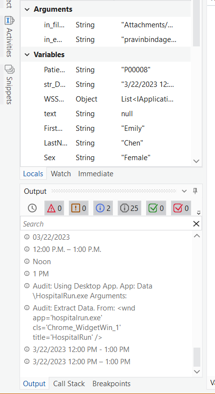

Replace Dash sign with hyphen
How to replace Dash sign with hyphen sign ?
Due to that my if condition goes to else part
@Sudharsan_Ka @supermanPunch @Anil_G
Look at bottom - 2 dates at output panel

still same
Input String - 12:00 PM – 1:00 PM
Op String - 12:00 PM - 1:00 PM

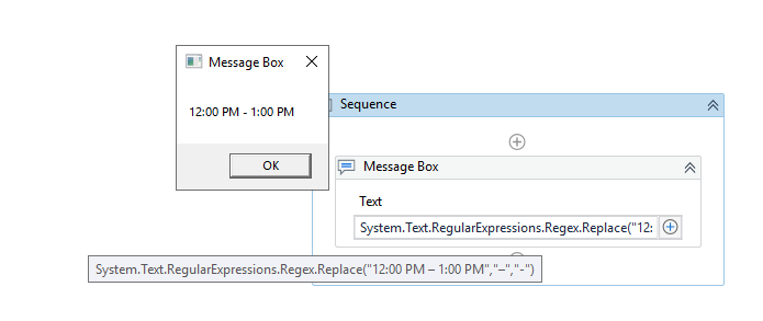

HI @pravin_bindage
Checkout this
System.Text.RegularExpressions.Regex.Replace("12:00 PM – 1:00 PM","–","-")
