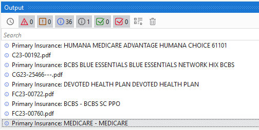

Hi @manikandan.murugan
You can try this way. This will work for all the inputs you have. Check out the workflow file.
Sequence4.xaml (12.9 KB)
Output:
Regards
