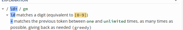

@ppr thank you. Could you elaborate more please?
@ppr if you do not mind, can you break this down for me?
strNo = System.Text.RegularExpressions.Regex.Match(YourStringVar,“\d+”).Value
For example, what does “\d+” represent? from the above syntax? Also, I was trying to see from the list the data type of the Value or or query on the right side of the equality sign. Thank you for your help

taken from
regex101.com
We attached the cheatsheet for regex and here you get also initial starter help
lets asume you have a variable with name: strText with the a value: “Transaction Number: 679937”
so extracting the number would look like this:
in case you need more general help checkout the courses from the UiPath Academy
For RnD and prototyping have also a look here:
@ppr , thanks a lot! That has worked for me. Thank you for the breakdown. That was helpful.
