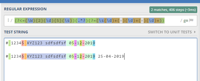

jbnhf23:
12345 XYZ123 sdfsdfsf 05-12-2019
jbnhf23:
12345 XYZ123 sdfsdfsf 05-12-2019 25-04-2019”
(?<=(\W){2}(\d){5}(\s))(.*?)(?=(\s(\d)+(-)(\d)+(-)(\d)+))
Hope that helps
