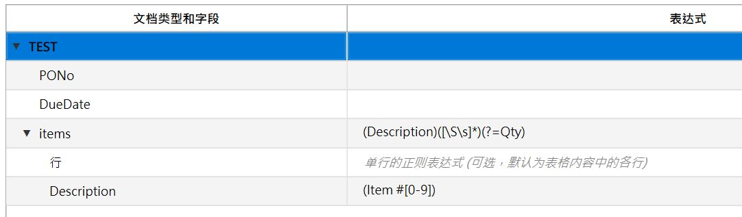

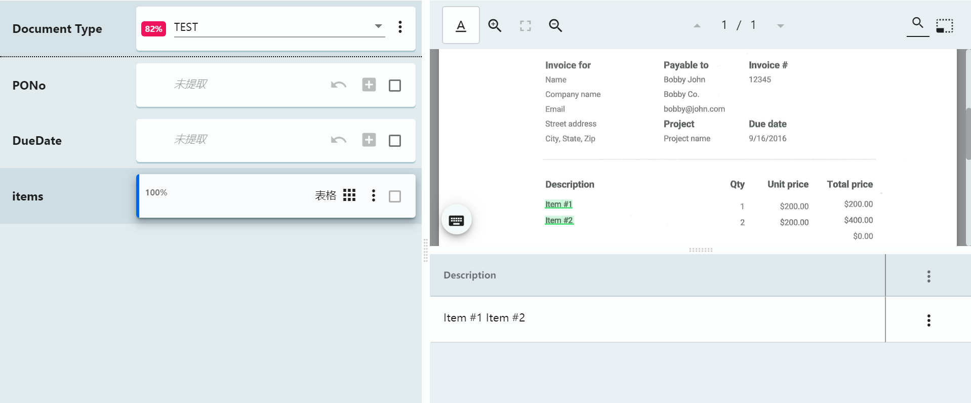

Hi , I tried to extract Table from .pdf , but I can only extract one row in the table I defined.(Items #1)
Can anyone help me extract “Items #1” , “Items #2” and so on ?
Thanks for reading my problem.

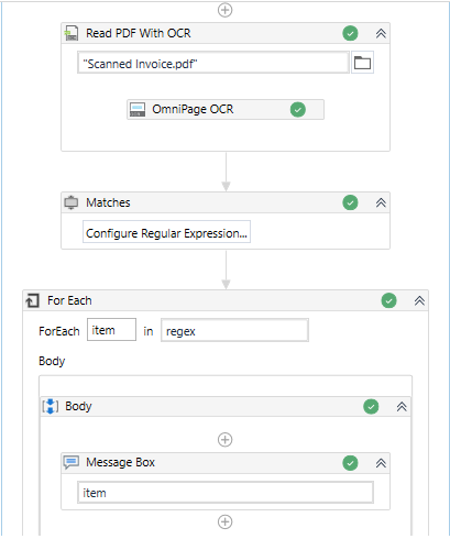

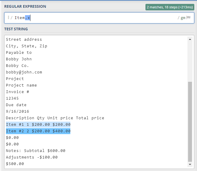

Hi @lojyehuang
Below is the Regex for the same :-
Below is the workflow for the same :-
MainPratik.xaml (8.9 KB)
Output :-
Mark as solution and like it if this helps you
Happy Automation
Best Regards
Er Pratik Wavhal
Thanks @Pratik_Wavhal for your fast reply.
your solution works fine.
Did you mean we can not use Regex based extractor to get each row about “item” ?
It seems that “item #1” and “item #2” will show in one row.
If we can’t solve this problem, I think your solution is the best answer.
