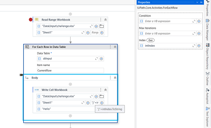

You can Use write cell activity, where you are iterating the your data table inside the loop you can write cell activity it will directly write the data to your J column. for more understading giving you sample flow snap. you can take as reference and try implement in your flow
Happy Automation!!
