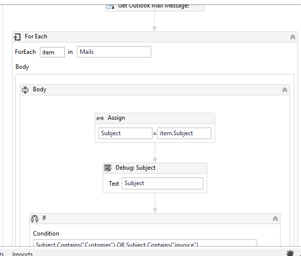

For reading I am using this workflow, further I am checking some condition but I need to reply from the same email only.
I understand your solution, But I first I have to read that email bro. then saving the file check on the basis of the file I have reply that email.
If I can see your solution you’re directly reply the email without reading it based on the subject line. Right me if I am wrong.

As you are looping through many mails, you can read the saved attachment within the for loop itself right @balkishan ???

So, try reading the mail within the for loop of iterating mails so that it will be easy to reply
You were almost done
The thing is once you have read the mail and made an analysis, you are still inside the loop with current mail been read under the iteration. So once we are done with analysis of the current mail atlast if the sequence we can use a send outlook mail activity and out the to property as item.From

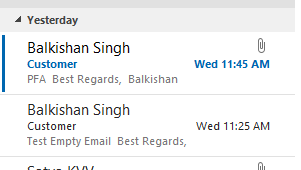

Here is no invoice number bro. this is the problem. The all mail has same subject like Customer Template so I am reading only customer only. so there is no specific id in email which we can identify the email which email we have to reply.
Ex.
I want the reply of the same email in the same email body.

no mailmessage as a variable
here you are in loop so i think the variable from for each loop (item) will be the one which has the mail message obtained from the list of mail messages (from get outlook mail activity)
–assign that variable item (of type mailmessage from for each loop) to another out_argument or a global variable so that we can mention that as input in the send outlook mail activity in the property FORWARD,
this will let know the user that they have received a reply mail for the one they have sent
Cheers @balkishan
here we are not looking at read or unread mail, that doesn’t matter buddy
once all the mails are fetch by get outlook mail activity these read or unread concept gets over…
now we are in processing mode inside the for each loop
–so while looping we will looking at each mail one by one
–while iterating for the first one, we will be analysing. save the mail message to a out argument or a global variable and getting to next workflow where we will be checking for the duplicate and if there is no such then we are sending a reply mail to the same person with this mail given as input to forward property so that the user will know that he has got reply mail (as we are still in the iteration, and next we will be going back to the loop where we are again going to validate the next mail and it goes on…)
