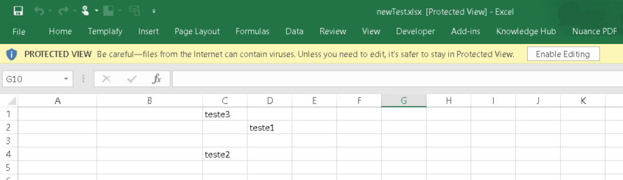

When I open the file manually, I see below the protected view. If I need to change the sheet manually, I always need to click Enable Editing. Could this be the problem? if yes, how could I use UiPath to get rid of the protected view? It’s not password protected btw.

The Enable editing wasn’t to be a problem, do you have permission to change this mapped folder?
Hello, I think I have the permission. Because if I enable editing, then I can change the document and save it (Manually)
You can used click activity to select protected view. If you are not getting the Enable Editing everytime. Please use element exists and if exists then click.
I have done this and it works fine for me. Particularly Enable Editing Button selector is common across hence you can use same selector for editing for all excels.
Just you need to refresh the connection in the data tab.
