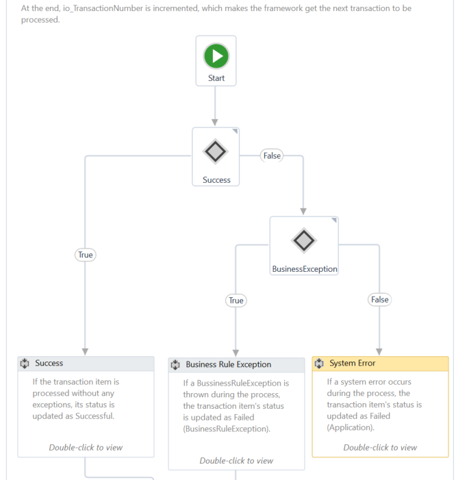

  1. How does the robot know that it should take the same Transaction Item in GetTransationData.xaml (we’re not increasing io_TransactionNumber in SetTransactionStatus.xaml) - so retry the same Transaction Item or whether it should proceed to the next one (when we actually are increasing io_TransactionNumber in SetTransactionStatus.xaml)? I see that in SetTransactionStatus.xaml after Business Rule Exception and Success path, we actually are increasing io_TransactionNumber by one (which would mean that we proceed to the next one when we go back to Get Transaction Data), but in Get Transaction Data I actually don’t see any indexing or any reference to the TransactionNumber variable/argument. The only parameters passed to the Get Transaction activity is Queue Name and output (out_TransactionItem).
  2. If we cannot pass TransactionNumber into Get Transaction Item, then what do we actually need it for? Is Get Transaction Item activity just taking randomly Items with New status from the specified queue? If so, then how can we stop it from taking a new one and make it take the same one (so, effectively, retrying the same Transaction Item when it’s needed)?

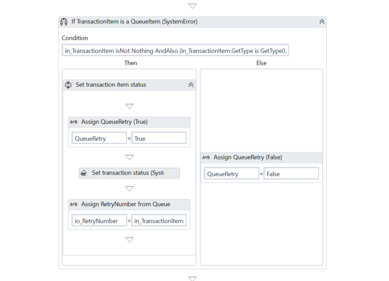

  1. In the above mentioned workflow, SetTransactionStatus.xaml, in the System Error sequence, I do not quite understand the logic behind QueueRetry. First we specify, that if we do have a TransactionItem and TransactionItem is of type QueueItem - we should set QueueRetry to true, otherwise false:

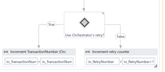

However, later in the workflow, we actually go to the next transaction (by incrementing io_TransactionNumber, just like in cases when do don’t want to retry - when MaxRetry was 0 or MaxRetry was reached) instead of increasing io_RetryNumber and taking up the same Transaction Item from Get Transaction Data - so in short words: shouldn’t it be other way round after “Use Orchestrator’s retry” Flow Decision?

When we have set in Orchestrator “Auto-Retry” as greater than zero, then for any system exception, Orchestrator will automatically add a New Queue Item to the Queue with status “New”, having “RetryNo” set to ‘1’.
So the Set transaction status workflow (RetryCurrentTransaction workflow) - in system exception after checking variable QueueRetry is incrementing Transaction Number to 1. This way it will eventually pick that New item (added by Orchestrator for retry). And code will check for “Transactionitem.RetryNo” to keep track of how many retires can be done.
