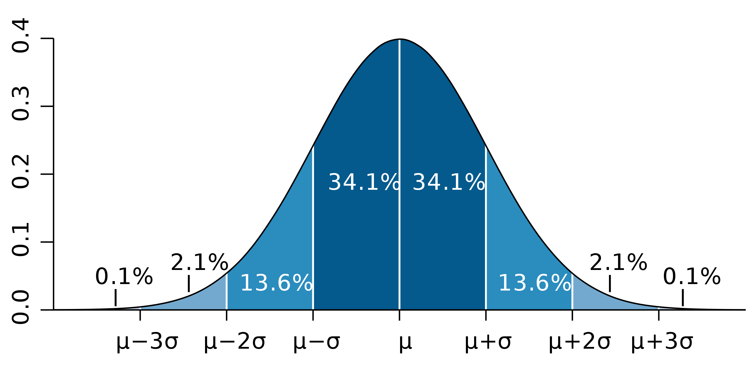

Hi @Tejaa,
Others have helped you here with ideas to achieve what you want.
I would just like to add one more discussion point here; law of large numbers.
Even with implemented randomness, your trigger time will endup with a normal distribution in the long run. So if you want the automation to run between 2 to 5 hours, you might notice that with time, your automation usually will run around the 1.5 hours mark. In your case, the true mean is = (5-2)/2. It will take a few thousands of runs for you to notice this pattern, but eventually you will see this occuring.
Law of large numbers - Wikipedia
Shorter explanation of Law of Large Numbers (probabilitycourse.com)
So now knowing this, if I was doing this myself, I would weigh the efforts needed to implement the workaround to introduce this randomness vs. setting a static delay (around the true mean) between runs using the advanced trigger (cron) expression.
