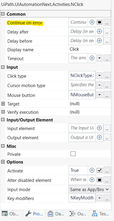

Hi @aprendiz
You can use the Try catch to handle the exception, In the second click activity that you are using in the Catch block. Open the properties of click activity and check the Continue on error option.
If it fails, it didn’t throw any exception it will continue with the forward process.
Hope it helps!!
