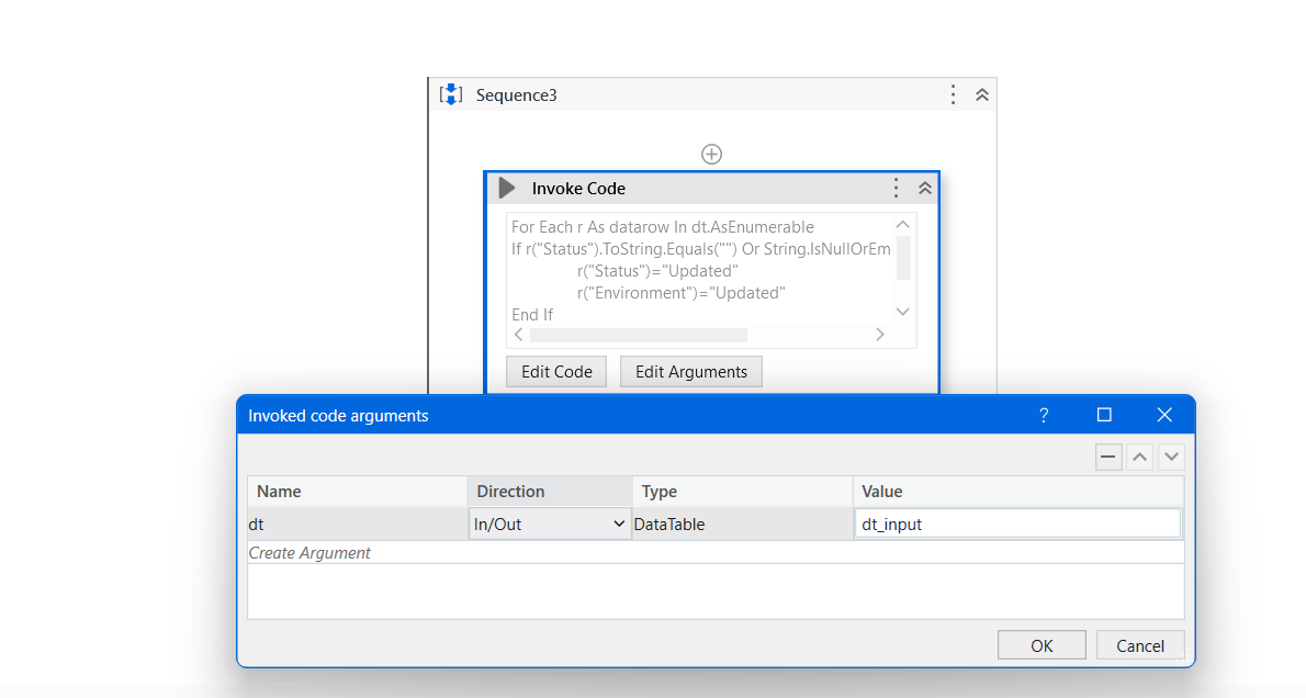

@Nancy29
its better to use invoke code activity to update the rows
For Each r As datarow In dt.AsEnumerable
If r("Status").ToString.Equals("") Or String.IsNullOrEmpty(r("Status").ToString) Then
	r("Status")="Updated"
	r("Environment")="Updated"
End If
Next
Try this and let me know , if you want to check for 2 columns then use the below code
If r.ItemArray.skip(2).All(Function(a) String.IsNullOrEmpty(a.ToString)) Then
End If
Next

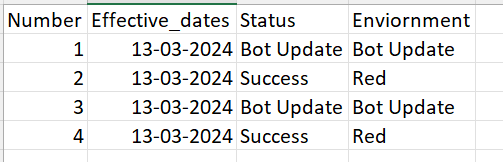

Simply you can use the LinQ Expression to do the same… @Nancy29
→ Use the Read range workbook activity to read the excel and store in a datatable called dt_Input.
→ Use assign activity and give the below linQ Expression,
- Assign -> dt_Output = (From row In dt_Input
                         Let Status = If(String.IsNullOrEmpty(row("Status").toString) AndAlso String.IsNullOrWhiteSpace(row("Status").toString),"Updated",row("Status").toString)
                         Let Environment = If(String.IsNullOrEmpty(row("Status").toString) AndAlso String.IsNullOrWhiteSpace(row("Status").toString),"Updated",row("Status").toString)
                         Select dt_Input.Clone().Rows.Add({row("Number"),row("EFFECTIVE_DATE"),Status,Environment})
                                   ).Copytodatatable()
→ Use Write range workbook activity to write the dt_Output datatable to same sheet.
Check the below workflow for better understanding,
Hope it helps!!
Input:-
Output:-
Xaml File:-
