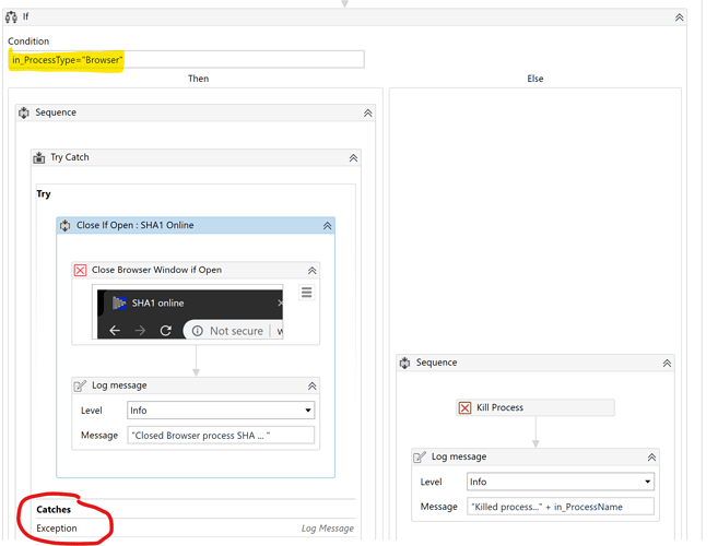

An update: I’ve been working on the Client Security Hash Project. In this case, the process to kill are browser based. Therefore, what happens if the admin has left a browser window open on the robot machine?
Example: In my day to day work, we leave a browser page that monitors our integration processes open all the time. Won’t the robot kill this window too?
I made minor mods to my KillAllProcesses.xaml and it accepts a Process_Type argument from the config file. If the type value is Browser, the workflow tries to attach to Browser windows by specific titles and then close them out. In this case, these windows are like ACME* and SHA* . If these windows aren’t found, the Catch block will bury the exception with a silent Log message. Here’s how it looks:
