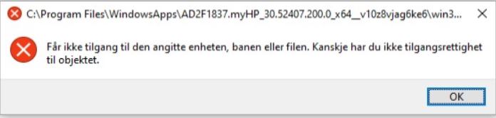

After launching the PiP session, a prompt pops up related to access to C:\Program Files\WindowsApps folder. Dismissing it brings up another prompt up related to the same folder. This is causing a hinderance to the Application execution and affecting the UAT execution.
First pop-up:
Second pop-up:
Can someone assist in explaining why these are being prompted in PiP for some users?

We have similar problem in our organization.
Processes for some users fails only when PiP is activated.
Why are UiPath trying to start app’s from “c:\program files\windowsapps” when using PiP?
The processes seems to be running fine without PiP enabled.
