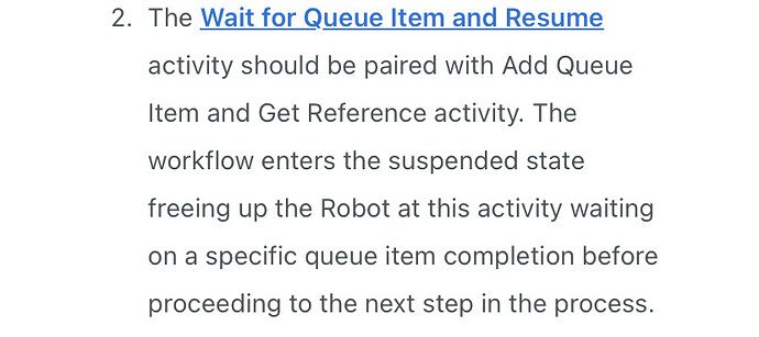

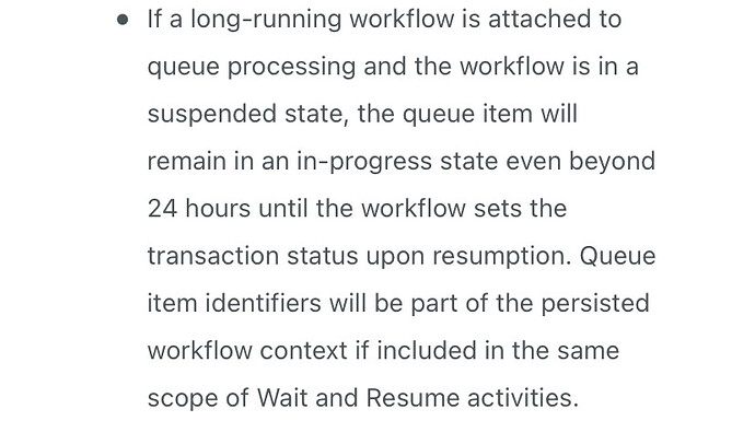

There are few cautions which we need to take…if you can open the link provided above and can go through each point then we might get some missing detail. out of which few I have provided above as well which might be missed…
