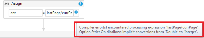

I’ve created three variables namely cnt, currPage, and lastPage. Their variable type is set to Int32. When I try to divide it using Assign Activity
I get this error: Compiler error(s) encountered processing expression “lastPage/currPage”. Option Strict On disallows implicit conversion from ‘Double’ to ‘Integer’
Take note that I set my variables as integer
you can try this
use write line
math.Round(lastPage/currPage)
Does that mean I have to change the quotient’s variable to string?
you can try this math.Round( lastPage/currPage)

Hey! Thanks, it works.
The division done here would result in a double (with decimal), while the variable you are trying to assign to is an Integer. It can either be cast to an Int and truncate the result, or use Round().
