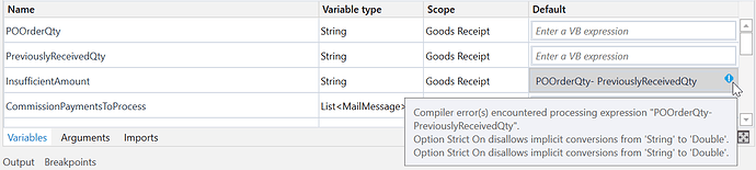

I am trying to do a calculation where:
Purchase order quantity MINUS Previously received quantity = Remaining Amount
I get an error "option strict on disallows implicit conversations from ‘String’ to ‘Double’. What does this mean?

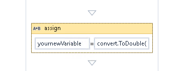

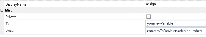

use Convert.ToInt32(yourvariable) or Convert.toDouble(yourvariable)

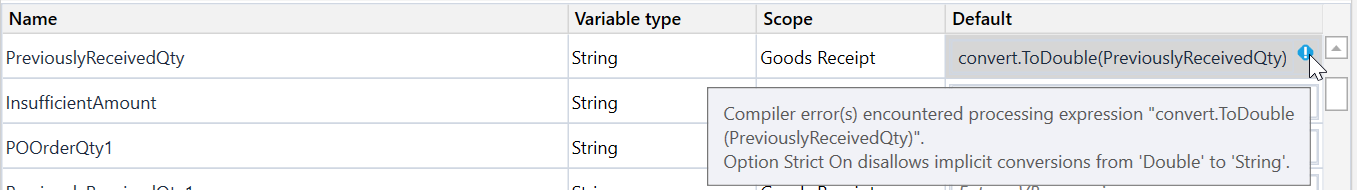

Thanks for your response. I attempted to convert a string variable to a double and I got the attached error.
Jeff
All your variables are of type String. You cannot do subtraction on strings. Best way would be to change the type of all those variables to System.Double.

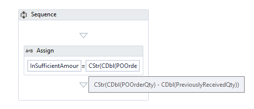

If you are particular to keep the variables as String use the expression like below. Use it in an assign activity instead of using it in Default.
CStr(CDbl(POOrderQty) - CDbl(PreviouslyReceivedQty))
Note: The above expression could cause errors, if your String variables are not valid numbers
