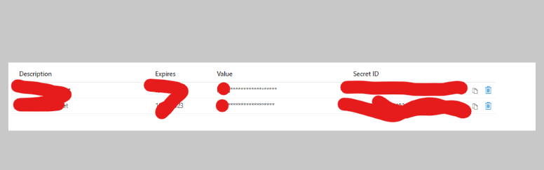

Hey I am also having this same issue:
auth used in uipath: ApplicationID and Secret
I have created secret key in azure and passed the secret key into secureapplicationsecret field in properties.
I am getting error as below:
lol
Permissions provided looks like as above.
Please assist!!

Also the application secret you provided in the properties is the masked value from the azure portal under VALUE column right?
Yes, the secret is VALUE column. But in your case, you want to get files in onedrive folders, I checked fiddler with uipath activity, it used request /v1.0/me/drive/microsoft.graph.sharedWithMe(), which need delegate authentication type(need behalf on user).
