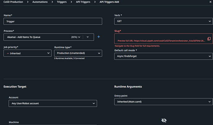

Where do i enter the info for my existing connector in the api trigger window? is it the Slug value? if so what value am i supposed to enter there?
Hi @david.rya.goderre1
try like this,
  • Name: New Ticket Trigger (or any descriptive name)
  • Verb: POST (or based on the API sending the webhook, commonly POST)
  • Slug: new-ticket-event (must be URL-friendly: lowercase, hyphens only, no spaces)
  • Process: Select your desired process, e.g., Akamai - Add Items To Queue
  • Default call mode: Async fire&forget (default is fine unless you want response sync)
  • Job priority: Inherited or change to Low, Medium, High as needed
  • Runtime type: Production (Unattended) (as shown)
  • Account: Select specific robot or Any User/Robot account
  • Machine: Leave blank unless targeting specific machine
  • Entry point: Inherited (Main.xaml) or choose a different XAML if needed
Make sure:
  • Your process has no input arguments or default values are set
  • The Slug is unique and formatted like lowercase-hyphen-format
Happy Automation

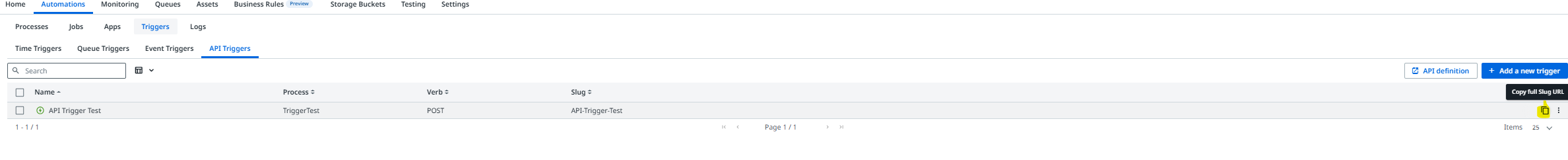

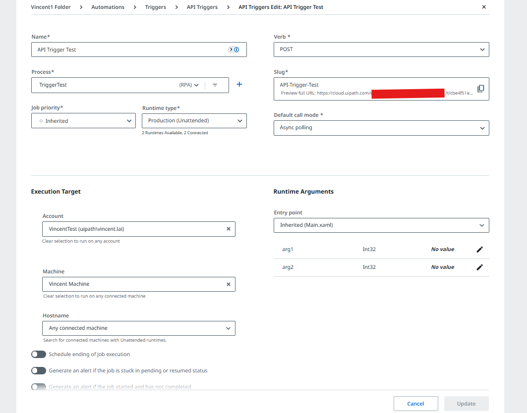

Let me see if I can help address your questions. So per the documentation, I created an API Trigger first:

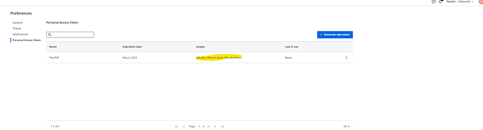

Next, in regards to authentication, the recommendation is to set up a PAT Token. End result should look something like the following (I highlighted the minimal job scopes I gave my PAT token):

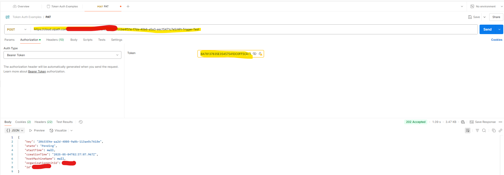

You then want to input said token into your 3rd party application as well as your slug url. In my case, I used Postman:
Copy Slug URL from API Trigger
Enter Values in Postman
Once I clicked β€œSend” in Postman, then the job instantly spun up on the Orchestrator side:
In short, API triggers are tied to the api call generated/the slug url you specify when creating the trigger and not IS connections specifically. Please let me know if this helps!
