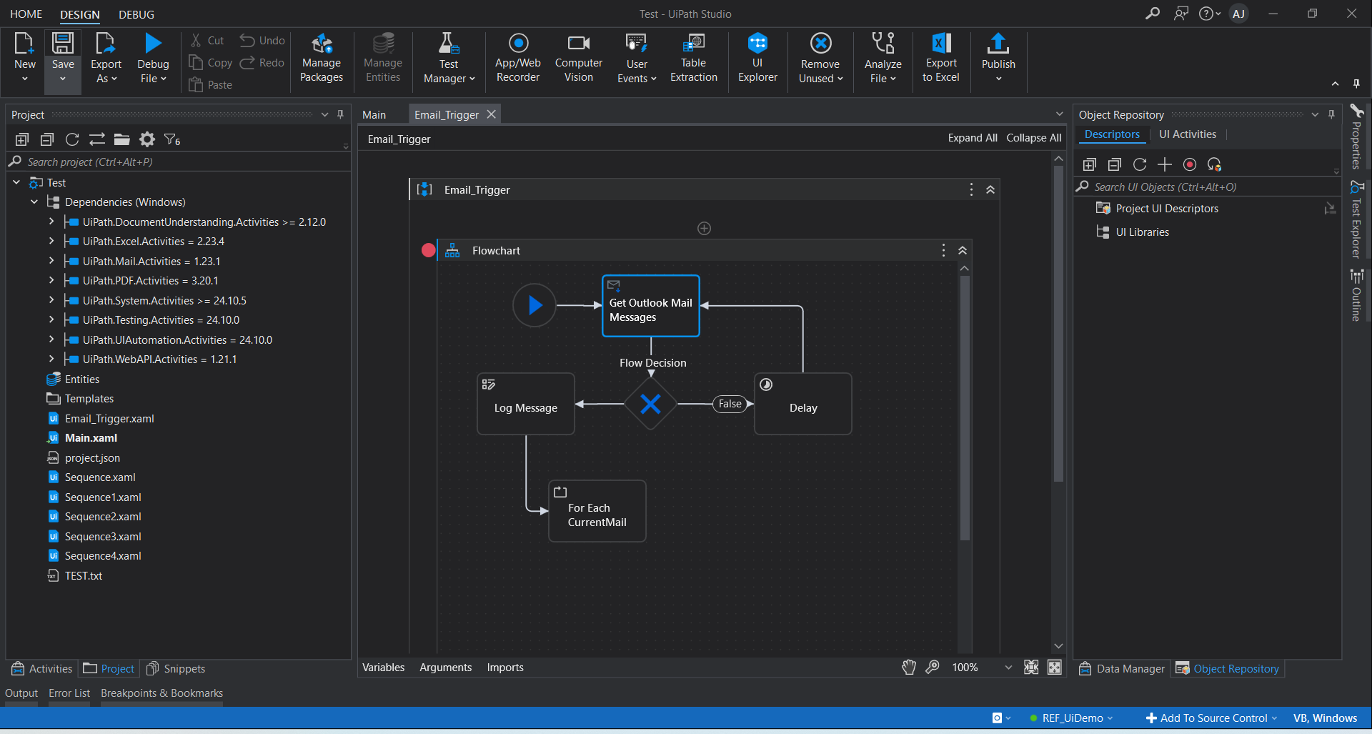

Hi @Soudios email trigger is not working I tried in flowchart and state machine both this activity should execute in first before process start in am attaching workflow for your reference as i have workaround i hope that will solve your issue
Email_Trigger.zip (2.9 KB)
