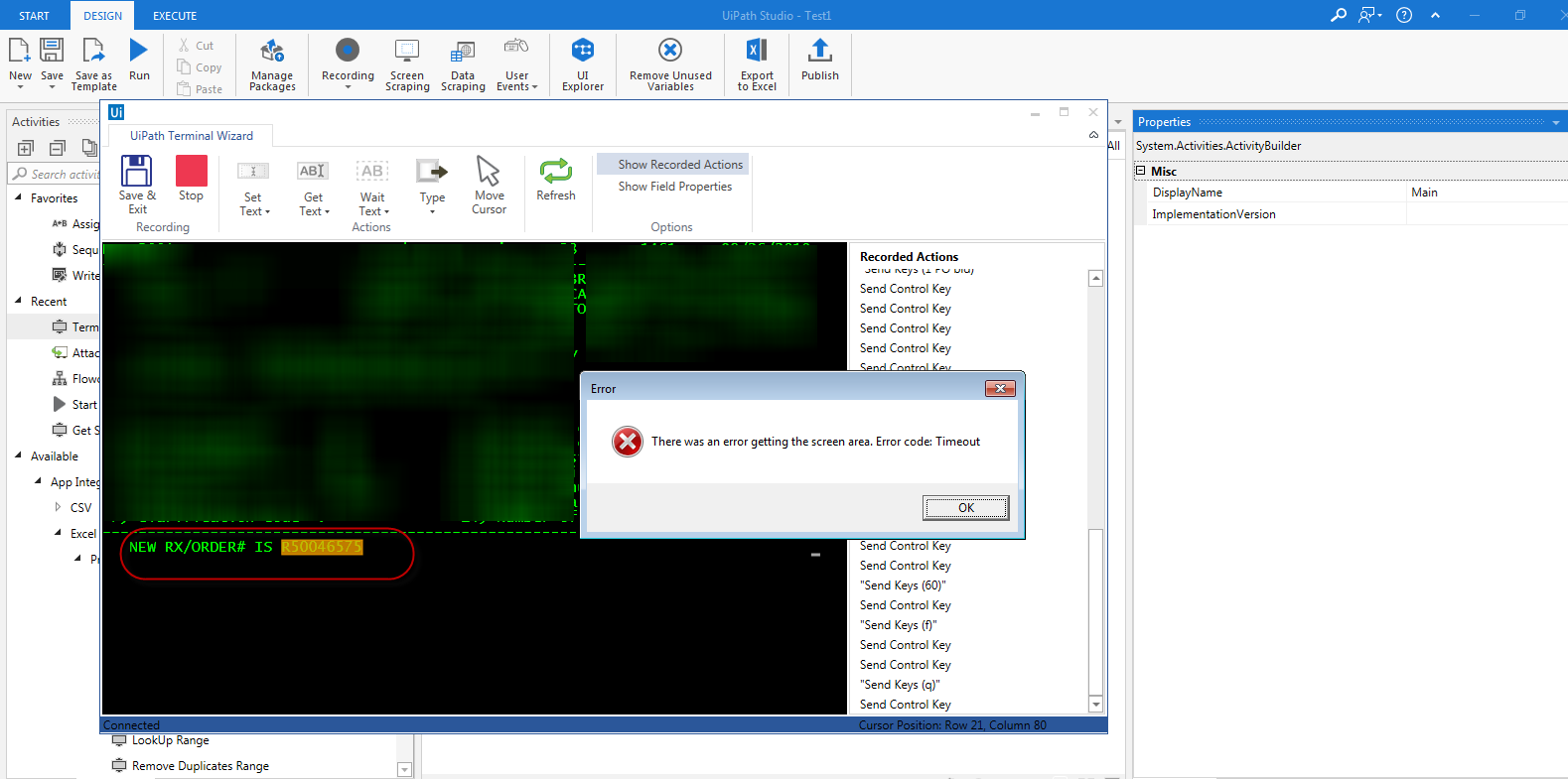

  1. I was filling an order in order entry screen . At final step when i get an order number I am not able to capture that value using get text activity. I am getting timeout error. is there any way to capture the value and store it anywhere for future use?

The value looks like this

Sir…I want to capture this highlighted data (RX#) but I am not getting an option to do that

I would suggest getting outside the wizard, because it could be the wizard causing that error. You should be able to use Get Screen Text or Get Text at position for that. If you use Get Screen Text, then you would need to use .Split() to get the text you need.
I really don’t like the idea of you using Attach Window with the element Get Text for Terminal interaction. But, that’s just my opinion, and I am not sure on your terminal emulator which you are using.

It is attachmate reflection terminal emulator…I am not using attach windowas well…i am using simple terminal session…which open this screen…I am also getting time out error in get screen text…I am not sure how to go outside the wizard and get that value.
I meant to exit the wizard and place the activities in your Terminal Session activity. Then run it from Studio to see if it gets the text. You can check the text by using a Message Box with the variable used in the Output property of either the Get Screen Text or Get Text at position.
