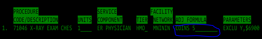

I am trying to extract Adj formula below value and need to verify that is expected one or not. Can anyone let me know how to scrape that information…Waiting for response…Thanks!

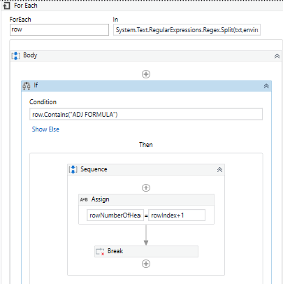

try this @sjetti
TestA.xaml (13.7 KB)
get text activity to read whole screen to txt string variable
get rowNumberOfHeader using foreach loop
set rowNumber (integer variable) =
rowNumberOfHeader + 1 -
set columnNumber (integer) to =
System.Text.RegularExpressions.Regex.Split(txt,environment.NewLine)(rowNumberOfHeader-1).IndexOf("ADJ FORMULA") -
use get text at position activity, pass in rowNumber and columnNumber
sorry should be rowNumber on the left,
columnNumber on the right
That is NOT how you automate in mainframe. The Terminal Activities provide everything you need.
NO, you do not use regular activities for mainframe automation. In a mainframe that field is always going to be in the same position.
Use Get Text at Position to get the value and put it into a variable.
