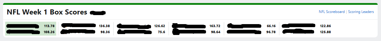

This may be a beginner question but how would I go about creating a loop that could start at each matchup, scrape the data, and then click the next matchup to the right (to the right of the highlighted green), and do the same thing. I have gotten the data scrapping down so that it works, but is there a way to run a loop to have it scrape through all 6 matchups? Like a ‘For Each Element on Page, Click to the Right’?

Sorry, I should have mentioned that those scores act as tabs on the top of the page. So, clicking on the box on the left (the one with 113 and highlighted green) will display data below that I want to scrape, and clicking the tab to the right (136) will display different data below. I am trying to loop through so where it clicks one, scrapes the data below, then clicks the next tab to the right, and scrapes that data until it does all tabs. Is there a way to do that within a loop, so I am not making 6 individual clicks and 6 individual data scrapes?

  1. For each ui element and indicate tabs
  2. Inside loop use click and send current element
  3. Next use extract datatable activity or table extraction to get data
  4. Write to excel or anything you need
make sure extract datatable selector does not contain any tab specific info…to make sure indicate on a tab…refresh page and select another tab and try validating and highlighting and select attributes whcih are common across all tab pages tables
