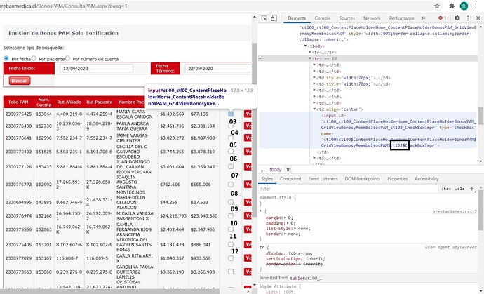

Hello friends, I need all your wisdom, I have this case in which I have to do multiple downloads of pdf files and I have to select a box called for this example “A” as you see in the image, and then download by clicking on "B As you can see in the image, the complicated thing for me at the moment is that it is a daily download and it may be that I have 0 boxes or 2 download sheets, as in this case, can someone guide me with the activities that I can use? Thank you.

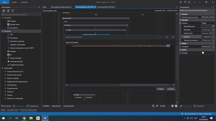

Hello friends, I want to tell you how my case is going, I have a dynamic selector that makes an iteration between several boxes that must be selected and then perform a download to achieve this I have a counter + 1 that is responsible for making the sum of the value of the selector the box, the problem occurs when the iteration reaches 10 the robot clicks on the value 10 but does not get the next one, which should be 11.
You mean when Contador is 11 you get an error? What exactly happens?
