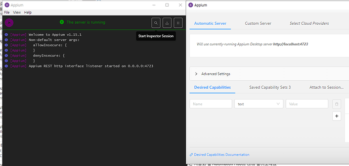

Hi Minal!
Please send a Screenshot of how you configured the app and the device.
Which Device did you configure on the other end? An emulator or a real device? What does the Appium Console show you?
Thanks,
Bye,
Chris
It is showing exactly the same as your screen @JIHUN
