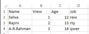

Hello Everyone,
I am trying to merge two datatable but when I merge it, an unnecessary column (Column1) is displayed. Please find the output in screenshot below. I have attached the xaml file as well. Please note “View” column is from different excel sheet and rest of the columns(S.no, Name and Field) are from another excel sheet
3 2 ,
1 Main.xaml (9.1 KB)
Datatable.rows.count returns blank output

I am confused with your problem again.
This doesn’t appear anymore. So I guess problem solved! Unless you were facing some other issue.
Were you expecting an output like this?
If yes, then I am not sure if merge data table would be the right activity to do this.
#7
@kaderms - I am expecting an output like shown in your screenshot. How can I achieve that? Did you get to see my workflow? If merge datatable doesn’t help with this, should I only be using for each to achieve this which is like kind of a lengthy way to do this.
My usecase is like, Name, Age and Job columns might differ but View column will always remain same but just repeat for every 3 rows. From excel row number 5, again the view column value would be ‘1’.
I will extract data from an web app for the columns Name, Age and Job everyday and store it in dt1 and then merge it with dt2 which only has view column.
Finally append the dt1(destination) table data to another excel sheet which has previous day records of dt1(dt1+dt2 merged)
Can you please help?
Thanks
Selva
#8
How about doing it this way?
After the above step
Add Data Column - “View”
Assign counter = 0
For Each Row in dt1
row(“View”) = (counter mod 3) + 1
counter = counter + 1
Your dt1 has all the data like how it is in my screenshot above.
