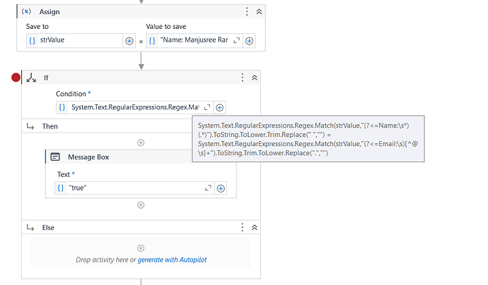

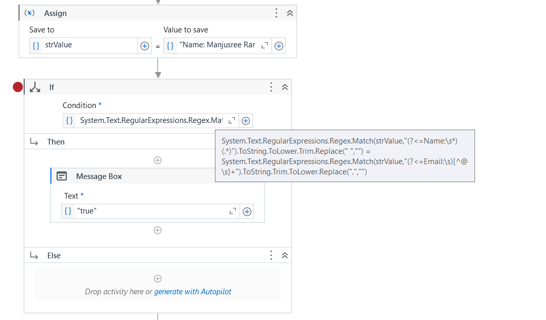

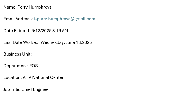

I have email as attched in that i need to check whether Name and Email Address are matching or not.
Sometime the Name contains three words as well.

@ManjuNarasappa
Take an if activity
in that condition fields you can pass below regex pattern
System.Text.RegularExpressions.Regex.Match(strValue,β(?<=Name:\s*)(.*)β).ToString.ToLower.Trim.Replace(" β,ββ) = System.Text.RegularExpressions.Regex.Match(strValue,β(?<=Email:\s)[^@\s]+β).ToString.Trim.ToLower.Replace(β.β,β")
Here this will first extract the name from input data as Manjusree Ramapura Narasappa and it will convert to all characters to lower and remove the space between of the words. Final output will be for the name
manjusreeramapuranarasappa
and coming to email
it will extract before of the @ and convert it lower and remove the dots(.)
now it will compare both are same or not.

You appear to be sharing details of a real persons email address of someone who works for the American Heart Association.
I think they would be quite annoyed you are sharing their name and email publically like this and you might be violating some local company policies doing so.
I suggest you remove these screenshots and in the future use dummy data.

It works when
Name : Manjusree Ramapura Narasappa
Email Address: Manjusree.RamapuraNarasappa@gmail.com
But is not working when the data as below and giving as False
Name : Vinay Prasad RN
Email Address: t-Vinay.Prasad.RN@gmail.com
Please suggest how to remove t- if is there and check for the match

I want to remove only t- and check the mail address.but If the mail address like below bot is going to else part and throwing error.
for eg:
Name : Vinay Prasad-RN
Email adres: Vinay.Prasad-RN@gmail.com
Bot extracting name as : VinayPrasad-RN and Email as : RN
Please sujest only to remove t- in the starting of the email
