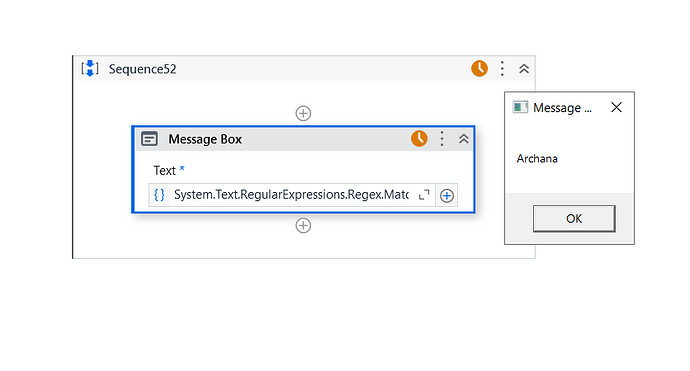

Hi @Happy_Coding
Check out the below workflow:
Input = "RE: 9967_Rihan Joshi ABC & Student Certificate"
Output = System.Text.RegularExpressions.Regex.Match(Input,"(?<=RE\:\s+\d+_)[A-Za-z]+").Value.Trim()
Input = "RE: 6514_Archana & Student Certificate"
Hope it helps!!
Yoichi
(Yoichi)
