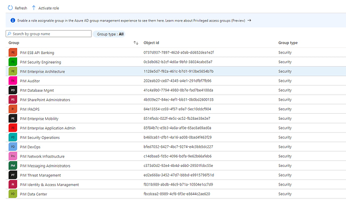

i need to click on each of the links below and scrape the information that exists in each of these links. i’m good with automating the info once i click on the links but my question is what would be the best way to loop through all of the links on the first page? here is the process:
  1. click on the first link, scrape the info needed
  2. go back to the page (screenshot below) and click the next link
  3. perform this same process until completed
    Can this be done straight from the website?
Thanks,
Deaser59

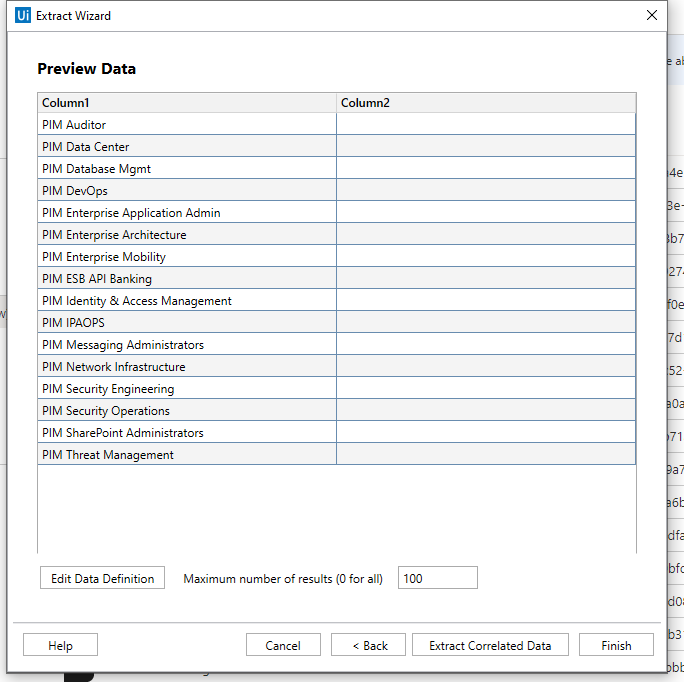

It might be done easier IF you are able to use Data Scraping on this page:
If yes, when you click on data scraping, first click on your first element, then click on your second element, and check if the bot gets all the names, then check the option to get the URL:
Then what you will have to do would be
  1. Scrape the data & get the URL in a datatable
  2. Use foreach row in datatable and use navigate to activity to go to all the URLs listes to get the wanted data
i’m not getting other URLs when scraping. Any suggestions?
